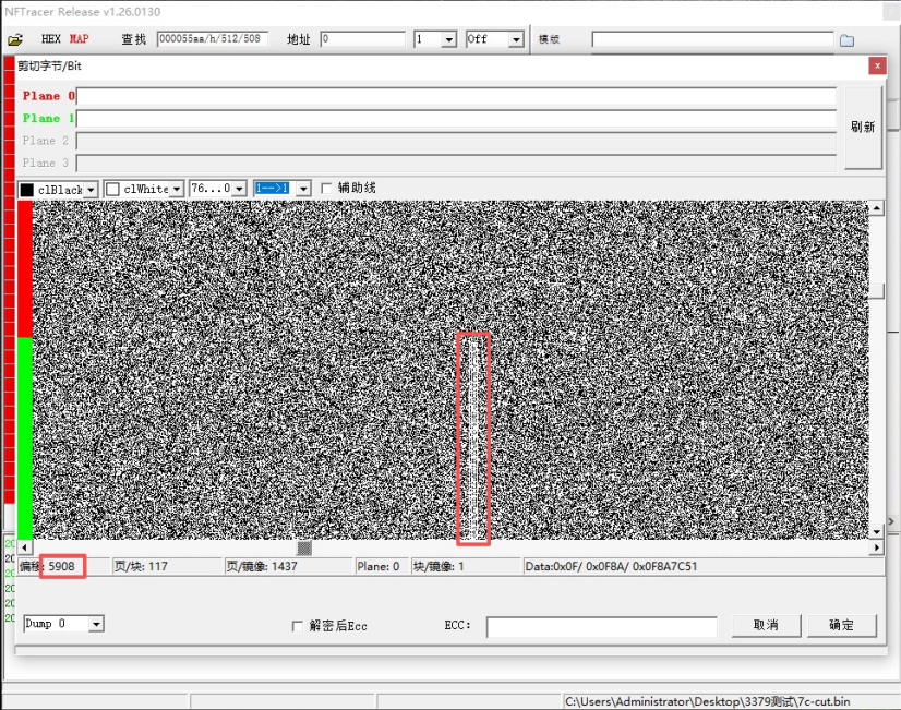

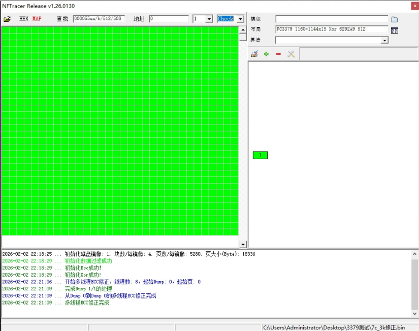

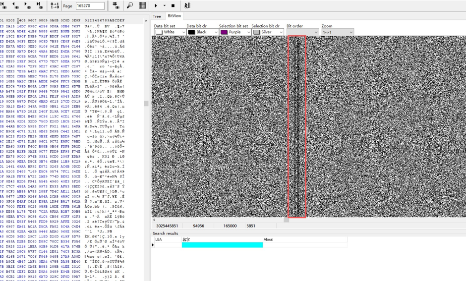

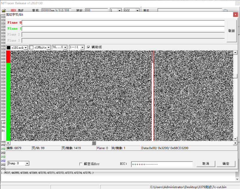

This screenshot shows that after cutting a large number of bits and then performing ECC correction, more serious errors occur.

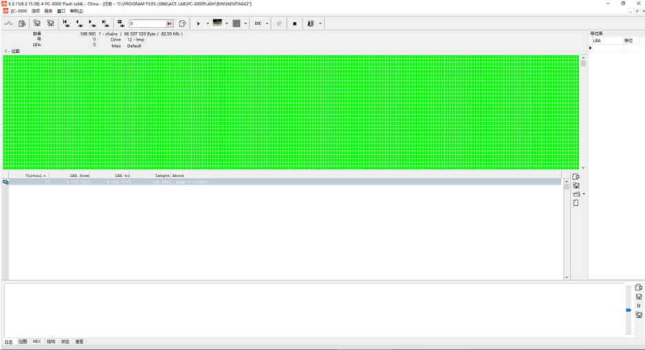

However, the ECC status displayed in the map shows all corrections as successful.

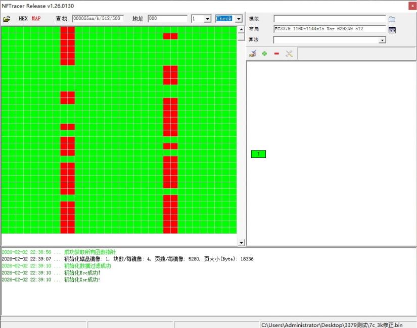

Switching to NFT, you can clearly see this issue.

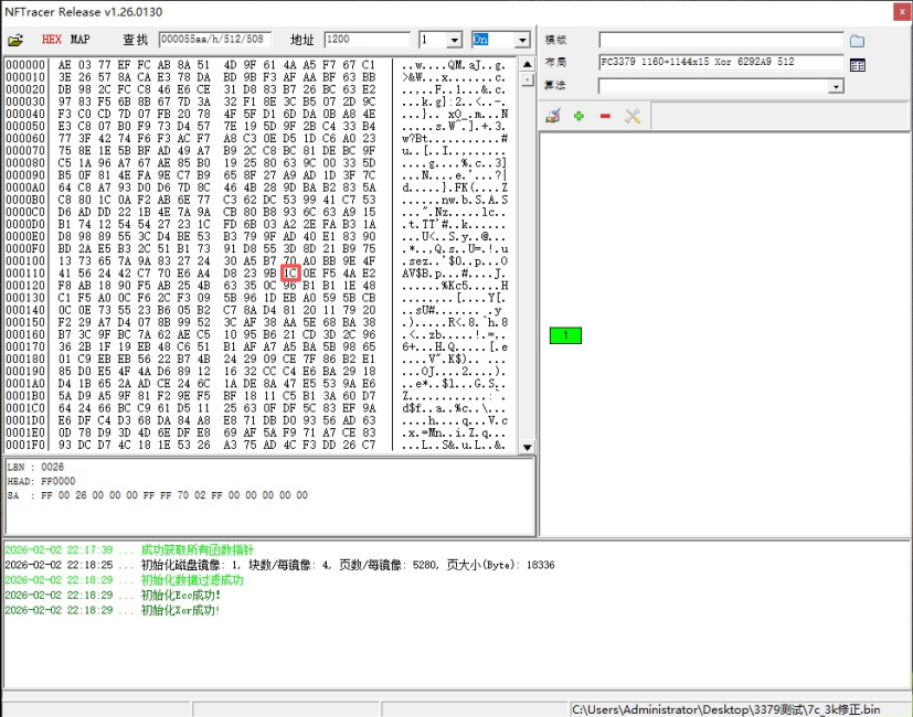

When viewing the HEX data and switching the ECC status, obvious uncorrected errors can be seen.

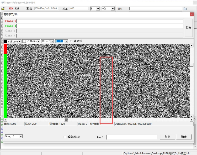

View the bitmap.
Before NFT correction:

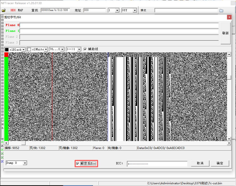

After NFT correction:

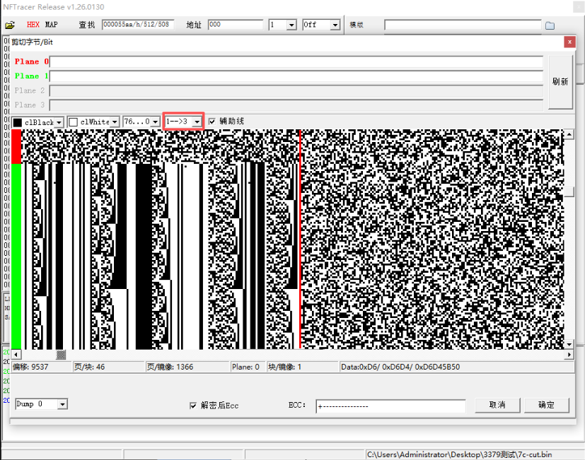

FC3379 byte and bit cutting

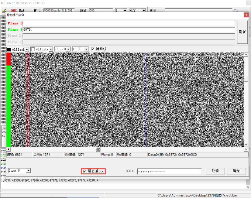

For certain unobservable error bytes and bits, tick Decrypted ECC to assist with error analysis and judgment.
Increase the bitmap display scale to accurately locate the bit positions that need to be cut.

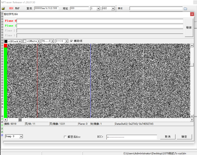

For example, in the following cases:
You can see that at position 6879, one bad byte is caused by cut bits and needs to be trimmed.

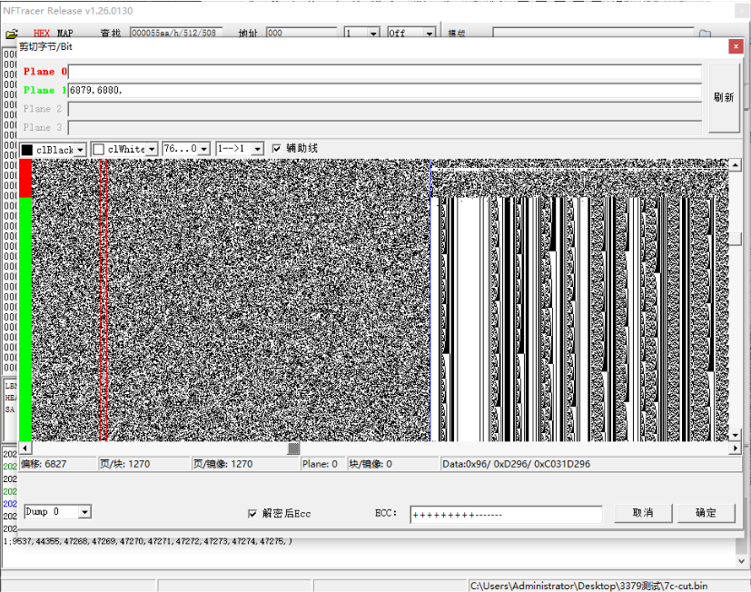

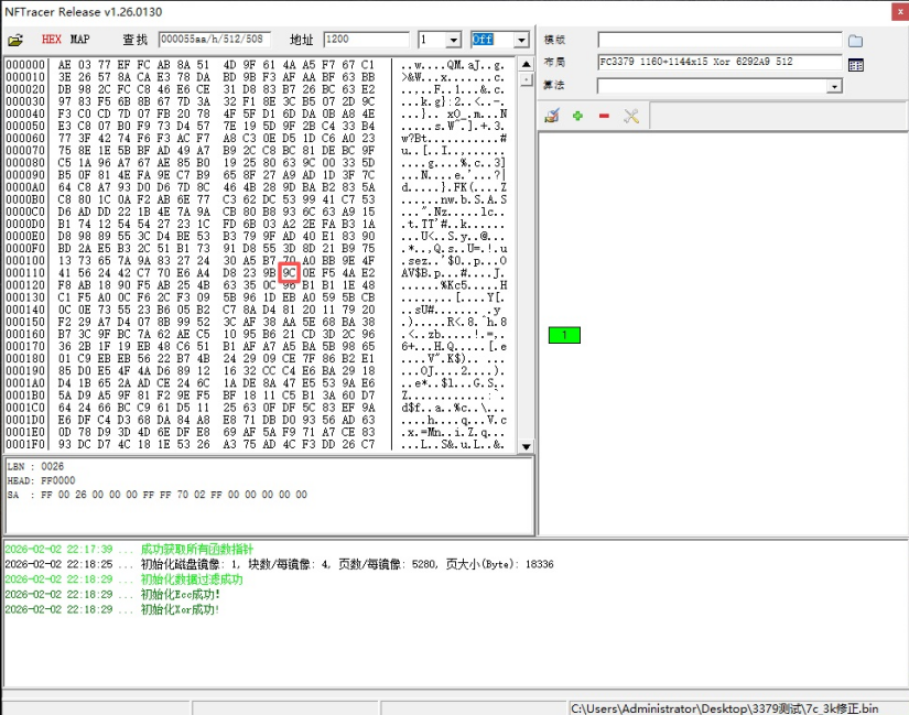

After trimming:
You can see that even after correctly trimming 1 byte, the subsequent data was not XORed correctly.
Additionally, it is strictly aligned with the end of Plane 0.
Nevertheless, the ECC for the current segment shows as verified and passed, which indicates there is one byte of unreported error at the ECC boundary.
After trimming, the subsequent data can be seen to have correct XOR results.
This type of issue used to be very troublesome when dealing with bit errors, but with the assistance of these functions, it is no longer a problem.
