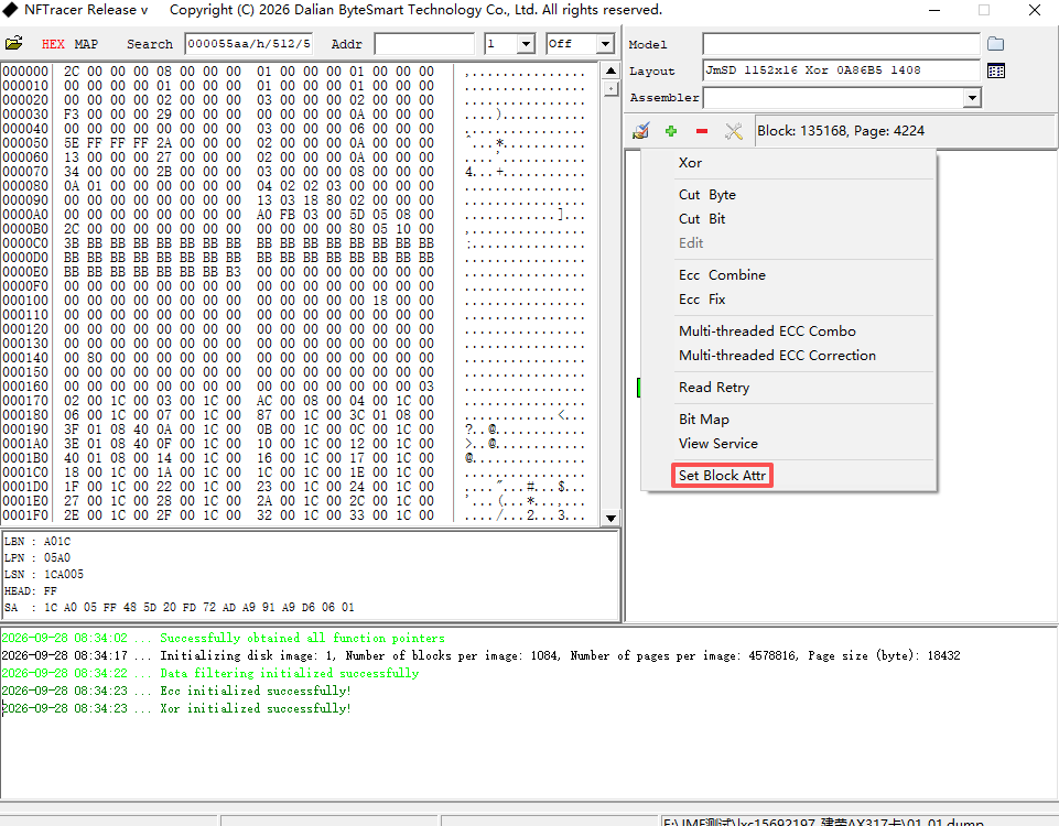

Operating ProcedureStep 1. Identify and Mark SLC Blocks
Open the Set Block Attr dialog via the right‑click menu.

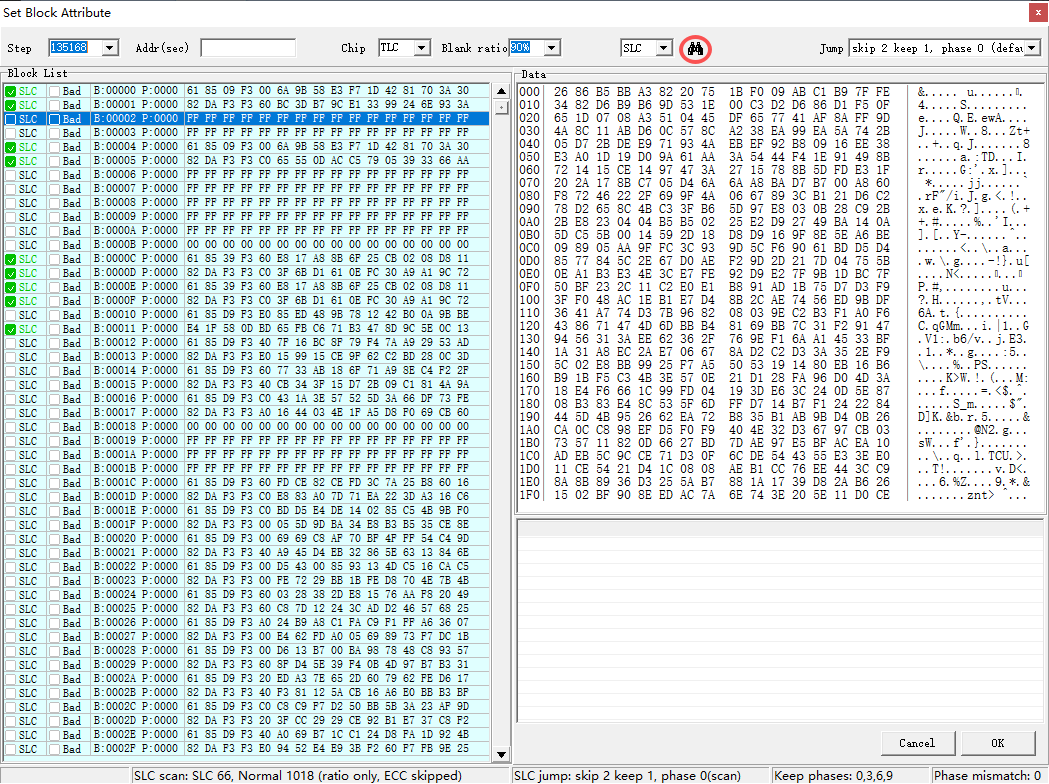

Click the auto‑scan button, and the software will automatically detect all SLC blocks within the image.
Click OK to confirm and finish block‑attribute marking.

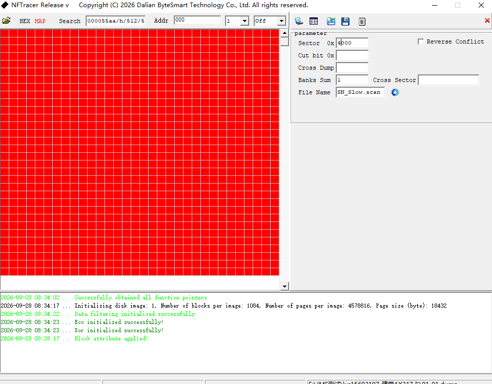

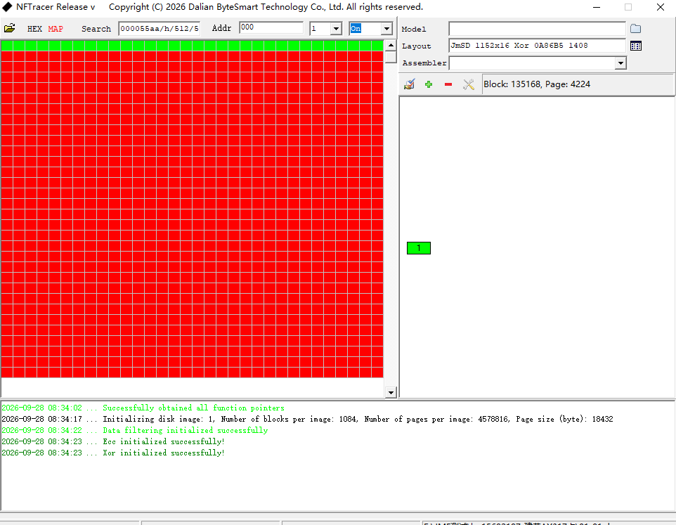

ECC Grid Comparison Before and After SLC Block Configuration
Before SLC block configuration: The ECC grid shows extensive red error indicators, indicating abnormal page error‑correction status.

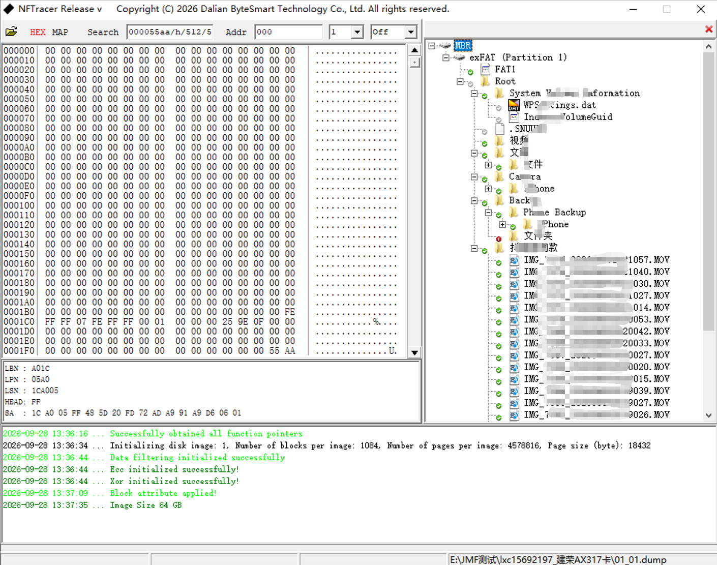

Recovery Result
Upon completion of sorting, nearly all directory structures and files are parsed correctly. Video files can be played directly without errors, marking a substantial improvement in recovery quality.
